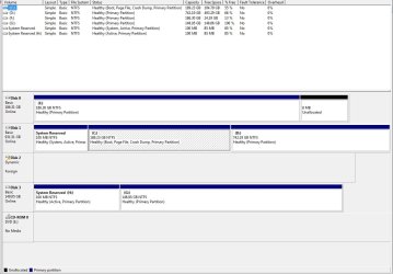

From the disk management screen I can not see it in the top portion of the window. At the bottom window I can see it however its says "disk2" with a yellow exclamation point. It also says dynamic below that and below that it says "foreign" The drive SHOULD have file on it unless something has gone horribly wrong. :o

Danny,
Could you post a screenshot of Disk Management with this? It will help us make sure that we advise you properly on this. :)
Here is the screen shot of the comp mngr and the device mngr. The hard drive letters you see in comp mngr are as folows ( I think ).

How were the contents of the drive created? If you right-click on the left square with the "!" , do you see an option "Convert to MBR" or "Convert to GPT"?

The drive itself is OK, it's the contents in it that are bugging Windows. It doesn't recognize what's in it, other than as a dynamic disk it can't digest.
In other words, you're not getting any data out of it as it is. Can you live with just being able to reconfigure it and use it, or do you need what at some point was in there? I sure hope not.
