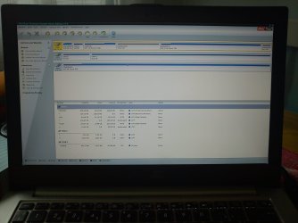

I took a picture of what Partition Wizard says with my mobile, I think it's easier than explaining how everything is… especially because I don't quite understand it all.

You have an EFI BIOS which means you must boot into it to repair the same way as to reinstall, shown here: UEFI (Unified Extensible Firmware Interface) - Install Windows 7 with - Windows 7 Forums
Thanks again Greg. This is starting to make a little sense to me now, finally, so hopefully we're on the right track.
Furthermore, when I looked at the contents of the first partition (SYSTEM) in Partition Wizard I saw that there were a lot of efi files (as well as efi.mui files) and my BIOS screen looks the same as what is on the page you linked.
