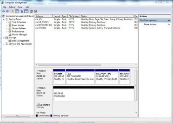

When I did as instructed, this is what I run into.
Right clicking on Disk 1 (on the lower half of the screen, since it's not listed above) only gives me the option to "Convert to Dynamic Disk" or to "Convert to GPT Disk".
and clicking on properties shows this.

A new drive that works on one PC but does not on another. I am really perplexed in this case. Are you sure that it works on your friend's computer? Did you try copying a file to it and then reading it? If not will you repeat and report? A disk management shot on it will also help. Now this is only of academic interest.:)
