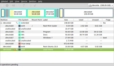

Here is the screenshot for the Disk Management, captured by using Gparted from Linux Mint 9.
Windows7 installation is in sda7. The earlier deleted primary partition is now divided into sda9 and the unallocated partition next to sda9.
I wish there is any other way/method to boot into that Windows7 again, without formatting. Please help. Thanks.

From just a quick look, it may be salvageable, I can't guarantee this but besides possibly missing some boot stuff that may be able to be reinstalled the extended partition is a problem I believe. A more experienced windows user will be needed here to take a look. I guess since you can't get into windows a screen shot from the disc manager isn't possible for them if needed. I use gparted all the time so I recognize the setup. I will be busy tomorrow writing a paper for a class, pacific LA time but I will look in on the progress. If you have to do a reinstall I think it will only be W7 the Linux stuff since it boots seems to be using the same grub. A custom install of W7 is easy if you have a install dvd.

The indicator in gparted for the extended is the light blue outline around the whole set, when you look at a gparted shot, and see partitions inside of a partition that is a extended partition generally, if you look closely you will see that that blue outline goes around the whole set and between the partitions.

Using Gparted I can't create primary partition from the unallocated partition inside extended partition. I can only created another primary partition by shrunk my sda4 partition (last partition in Gparted) and use the 'just unallocated partition' as the primary partition for the 200 MB partition required. That's all the difficult part, the rest of the steps are as same as mentioned by SIW2. Yeah at last, I managed to boot into windows7.
