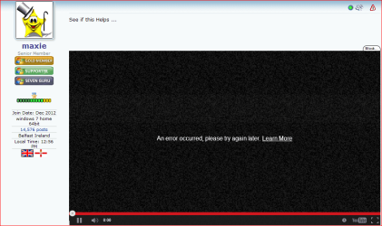

See if this Helps ...

Maxie, I can't run the flash video.
I tried Firefox and IE 11 on Win 8.1, everything is fully updated.
I have add-ons in FF that might cause this, but IE is "clean"...
Here's what I get

Try now David

Thanks, this plays for me :thumbsup:
