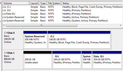

Here's the final snapshot. I moved some drive letters around to match a previous configuration. U is the old system which I will delete after I have redone my backups, and that second reserved partition was created when I installed fresh onto the WD disk. Thanks again.
Looks good! Glad you got it nailed down!!
