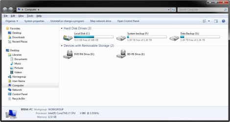

EXAMPLE: Control Panel in Navigation Pane
NOTE: This is the Control Panel added (default) (left screenshot below) and removed (right screenshot below) from the Navigation Pane when you have the Show all folders option checked or not checked.
