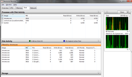

- Looking at Resource Monitor:
- There are barely any Hard Faults (as good as none)​
- Disk activity is very low (see attached screenshot)​
- 165 MB commited memory for the specific PID (for all chrome.exe it's around 900 MB)​
After all that nothing has changed, unfortunately.
