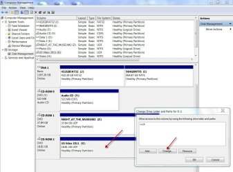

So, I take it that doing a drive clean up and releasing the drive letters and registry entries pertaining to the non-present drives, has resolved the problem of that one drive going intermittent.
I was really perturbed with that one CDROM drive that stole one drive letter that prevented you from assigning sequential drive letters to the internal HDD drives. Knowing fully well that it could come either from a virtual drive software and worse still from a WD external HDD with Smartware ( that cannot by any normal means be done away with) made me anxious. Reason why I was harsh about connecting an external drive while you are in the process of cleanup.:)
Ok now that you have conceded that it was indeed coming from a virtual drive software, here is how to give it a permanent drive letter.
Enable your virtual CDROM drive.
Mount an ISO on it.
Now go to Disk Management. You can see your Virtual drive with the automatically assigned drive letter.
Change the drive letter to one of the last few alphaphets. ( I had given it the drive letter X with the physical drives given Y and Z as in post #.18. Without anything mounted on it, the VCD will not show up in Windows Disk Management and so you cannot assign a specific drive letter to it.)
If you are plugging in and plugging out innumerable external drives and frequently - which seems to be true in your case - sooner or later you will again get into the problem of some drives not showing up due to drive letter confusion. So perform the drive Clean up periodically to flush out the non-present devices locking the drive letters in the registry.
As for as rearranging the disk numbers like Disk 0 , disk 1 etc.,, I really do not know whether it really matters, though it will look nice that way. I shall as I said earlier leave it to Britton30 to elaborate and guide you on it. ( I am not plain competent :))
Whether you should remove the active flags in non-system drives? As I said in post #8, theoretically as long as you are booting right it should be OK. But we always want to remain safe. Isn't it? From a practical standpoint, if you are not a multi OS operator as TVeblen pointed out and know your way, it is safer that you remove it from non-system drives.

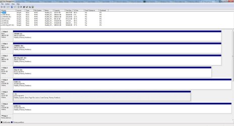

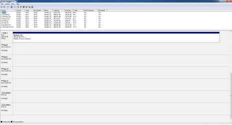

Drive G disappeared while using the computer after I installed the USB HDDs and memory card reader. My best guess is it's the Samsung USB 3 drive connected to the Orico PCI card. So I disconnected it and rebooted drive

Ok. Check if after plugging out the SAMSUNG USB3 drive the G drive does not disappear.( Monitor for a long time)
Also check what happens when you connect the Samsung drive to one of the USB2 ports on your computer.
Honestly, I couldn't reason out a connection between the Samsung external drive and one particular WD internal drive out of so many..
EDIT: In view of the unpredictable behaviour of drive G , I would advise that you forthwith backup all contents in it to another drive. If it is not the power cable/data cable or port fault which you can easily check by interchanging, some component in the G drive may be failing intermittently now, but can fail totally anytime. That's what I can intuitively reason.

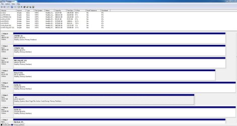

First off I guess reading emails sent to my phone when someone replies has caused me to miss multiple posts to the thread. I apologize to everyone who is posting here.
1) I removed the active flag on Drive I: (old drive U: before reordering drive letters), I didn't realize that there was another drive other than the old Win 7 (used to be L:) that had an active flag which I removed from the computer.
2) Bios has been in AHCI mode all along
3) The drive in question has been G: WD1GIGSAT now on disk 2
4) I have not had a problem with G: disappearing since unplugging my Samsung ext HDD on PCI USB 3.0 card
5) The reason the my SSD Boot drive is not on SATA_0 is because it's on GSATA3_6/7 (SATA 6Gb/s Connectors, Controlled by Marvell 9128). The other SATA controllers are 3Gb/s connectors. I don't know if it matters.
6) Drive G: is already backed up.
7) Should I just let the system run with the ext drives connected to see if any drives disappear as maybe removing the active flag from drive I: fixed the problem?

I would say yes. Pay close attention to cause and effect - I do this and then that happens (or doesn't happen). And keep copious notes.
"I have not had a problem with G: disappearing since unplugging my Samsung ext HDD on PCI USB 3.0 card"
I suspect that the problem may lie with this add on card. But you will need to pay close attention to whether the problem occurs before you access this card again.
"The reason the my SSD Boot drive is not on SATA_0 is because it's on GSATA3_6/7 (SATA 6Gb/s Connectors, Controlled by Marvell 9128). The other SATA controllers are 3Gb/s connectors. I don't know if it matters."
Yes it does. It explains why the drive will not show up as Disk 0. The native SATA ports will always be Disks 0-5, the add on Marvel controller will always be Disks 6 & 7.
