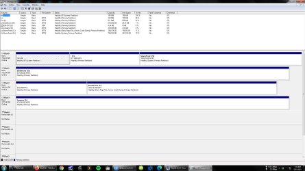

Post a screenshot of the disk management window.

On disk 2 you have a 228M partition without a letter assigned to it. What do you have on that partition?
To make a EFI partition on disk 2
- Shrink the 228M partition or on the C: partition by 60M.
- On the 60M unallocated partition, create a FAT32 partition and assign a W: letter to it.
Open a CMD window as administrator and type:
bcdboot C:\Windows /s W: /f UEFI
Shutdown, disconnect (SATA or power cable) disks 0, 1, & 3.
On BIOS change the boot priority to Windows boot manager from disk 0 to disk 2,
Power on and it should boot from drive 2
If it does, shutdown, reconnect (SATA or power cable) disks 0, 1, & 3.
Back to windows, delete the EFI partition on disk 0
Nothing? That was there before I even started. I think that's an MS reserved partition or something.
The rest of your instruction it looks like it will boot from disk 2 C drive afterwards. I want it to only boot from Disk 0 H drive. When it does I'm going to remove disk 2 C drive. Once everything's done I want to change that H: to C:
Now it is booting from EFI partition on disk 0 and transferring the boot sequence to disk 2 - C:
The drive letter is assigned by the OS. If you boot from disk 0, H: will become C:
Does disk 0 - H: has a OS on it?

This is a follow-up to Moving Win 7 to new drive
His issue is that the OS on D0P3 has no boot entry. I have suggested to execute
bcdboot H:\Windows
to create a dual boot of old and new Windows, thus not taking any boot option away immediately.
The boot files are on Drive 0 already.
