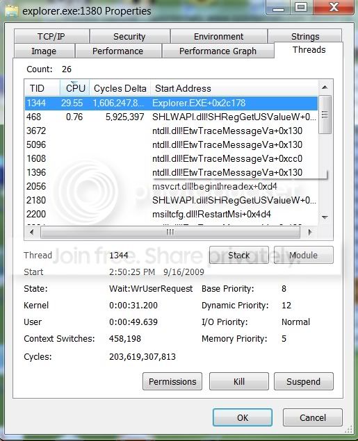

Here's the output of Process Explorer while moving my mouse pointer:

I was already able to trace explorer.exe and all processes I get have a PID of 1380.

I tried moving the mouse faster and the CPU moves at 5-7 %. Yours is a bit high than what it should be. Does it happen everytime?
