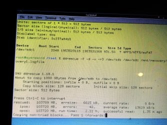

I am using the following command
ddrescue -f -d -r3 -v /dev/sdb /dev/sdc /dev/sda6/recovery.logfile
Sdb is failing hd sdc is new one and sda6 is my laptop partition on while iam trying to save logfile.
It shows :error writing logfile /dev/sda6/recovery.logfile not a directory
Even when i replace dev with media:no such file or directory
Edit:Nevermind got it its copy.fingers crossed:confused:

i had mount the partition using mount /dev/sda6 /mnt
and use
ddrescue -f -r3 -d -v /dev/sda /dev/sdb /mnt/recovery/recovery.logfile
btw the speed is good it has done 100gb.does it mean it is not hardware problem?
Now going very very slow

Good going. Good info that should help others trying to run ddrescue.
Looks like it has finished copying all the good sectors - that is always fast.
6615 KB in bad sectors.Now it is in the first pass trying to read the bad sectors so marked in the log file. Naturally it is a slow process.
Then second pass and then third.
When cloning is finished, let us see how and what your cloned drive presents.
