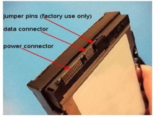

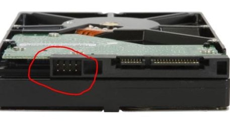

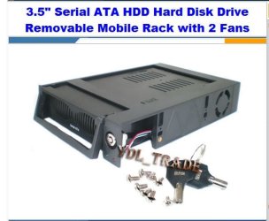

Is the WD drive IDE or SATA connections?

It looks like the top two pictures. He's going to put it in his brother's desktop today (I think) to see if it'll work. He doesnt want to wait to have the kit sent from eBay.
