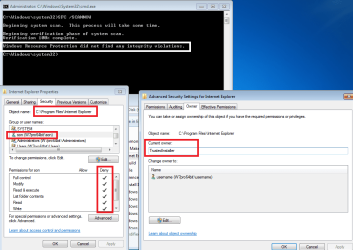

carwiz,
I think that we posted at almost the same time. I'm guessing that your statement, "I'm not sure about that" was meant to be a response to apertotes asking, "Can I return ownership to the Trusted Installer while still having my son denied permissions on some folders inside".

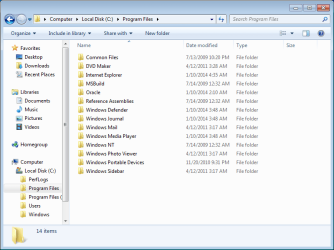

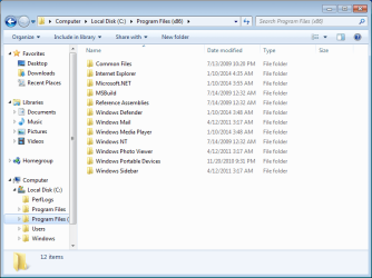

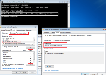

I went ahead and tested my understanding of the relationship between item ownership and NTFS access/deny permissions. While I was at it, I threw SFC into the mix :-)
SFC does not show any "integrity violations" - even though there is a security problem. This shows the results of an SFC scan while the user account named username has ownership of what should be a protected folder.
As I expected, returning ownership to TrustedInstaller did not cause any integrity violations and the Deny permissions held.

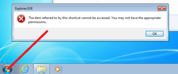

This is what the standard user account named son sees after ownership of the IE folder (and its contents) has been restored to that special account named TrustedInstaller:
apertotes,I realize that the IE folder (and its contents) was not the target of your Deny permissions settings; it was just an easy example for my testing and screenshots.

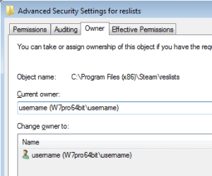

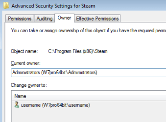

This was funny:
The top level folder for Steam is owned by:
Glancing thru the sub-folders (and some files)...
...shows them to be owned by the account that installed them.
Upon re-reading this thread, I noticed that you took ownership of the entire Programs Files folder structure (as opposed to just the folders that needed restrictions). So, let's follow the general rule that stuff that Windows installs should have TrustedInstaller as the owner and stuff that users installed can keep your account as the owner. This rule is very general because user installed apps can have the TrustedInstaller as the owner too.
Work thru each of the folders shown in the right hand pane and set the TrustedInstaller account as owner:
