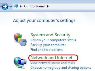

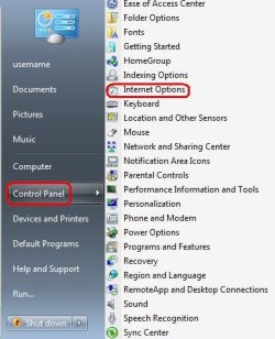

If you get IE to to show up again, try the control panel method of setting the home page to about:blank. If you still cannot find the Internet Options listed in the control panel, then paste this into the Start orb > search field
"C:\Program Files\Internet Explorer\iexplore.exe" -nohome
and hit enter.
If IE starts and does not lock up, then there was/is a problem with the home page that IE was attempting to get to.
You could also disconnect from the internet and start IE - it should fail to find the website, unless some local file has been set as the home page.
Attached are some screenshots of a couple of ways that the control panel might show in your system.
