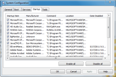

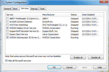

Here is the update. I have disable MANY applications (adobe, quicktime etc) from the start up menu in msconfig. The only thing I left active were windows services. This made a big difference...to a point. When I start my PC and open task manager, I see between 0 - 4% cpu usage and about 10% on memory. My computer has been running for about 15-20 minutes...and I am right back to were I started, 25% cpu usage and memory is about 72%, this is at idle (with this forum open).
I attached screen shots of both the performance tab of the task manager and of the services running in msconfig. Any thoughts on why usage would still be so high?
Thanks again, this is a little frustrating!

Fixed! Apparently windows media player file sharing is a resource hog (and mind you, I never opened the service). Once I turned off sharing and extender services things went back to normal.
Thanks for all the help.
