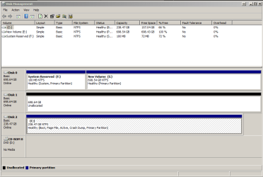

I have a bit of trouble here trying to move system reserved (F) to (C), so that my OS can operate independently without the need of the other partition.
Tried using BCDboot/easybcd, but if I remove the hdd which has the system reserved, windows wouldn't boot.
Here is a screenshot of disk manager:
http://i.imgur.com/KX0uEqM.png
Thanks in advance
W7 x64 ultimate english
Drive letter F is manually assigned

the SSD listed on my system specs is a M.2 SSD, it's not possible to switch cables / ports with the 2.5" SATA HDDs.
Edit: says bcd on either drive is corrupt right now

Sorry, I missed that in your specs. Well making it first priority is necessary for those instructions.
Since you already moved it, try running startup repair up to three times with boots in between to get the system flag to stick on your m.2.
http://www.sevenforums.com/tutorials/681-startup-repair.html
Unplug that drive with the current system reserved while you do that.

C: doesn't have the system flag though, that's on the F: right now.
I think just keeping the M.2 as first priority and unplugging the Disk 0 to prevent the system flag from being put there.
Then the 3 startup repairs would be enough.
There is an option on the installer to repair your computer, you can get to the startup repair from there.

The m.2 is the C: drive though.

At this point, would it be better to just wipe the m.2 drive and do a reinstall without HDD plugged in?

Oh oops you might have to extend F to the size of the disk2

Yikes I can't imagine how a m.2 got listed as disk2 that's whack :confused:
It's not using an SATA port would be my guess, it lists those first I guess.
I'm not familiar with them though so I could be wrong.

On boot it says HDD first then mSATA
AW18 bios A12 (UEFI + CSM)
I've heard that with win7 uefi+csm install, it's not recommended to store system reserve and C: in the same disk, why?

Well I guess he's lucky the m.2 ended up with C on it sort of ?
So yea start up repair after removing the 2 other disks should work
