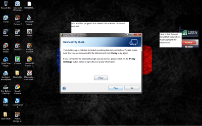

Yeah the thing is my Norton is not the full version and I have the installation of avg but when install it needs to connect to the internet and that's the problem I'm having.

Try uninstalling all your AV's, reboot & install the AV you would like.
This has been happening before i thought of downloading AVG.I believe the problem is the half install of AVG.
No. =(Can you update anything?
How do i do that again because i tried and it didn't work.( It's when the computer turning on and pressing F5 right?)Have you tried updating in safe mode with networking?

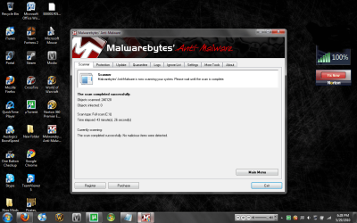

Nothing worked.Reboot and hit F8 or you can in the Run command type "msconfig" and click on the boot tab and click safe boot and click network. Click OK and reboot. While you're in safe mode you should scan with malwarebytes as well after you update it.
