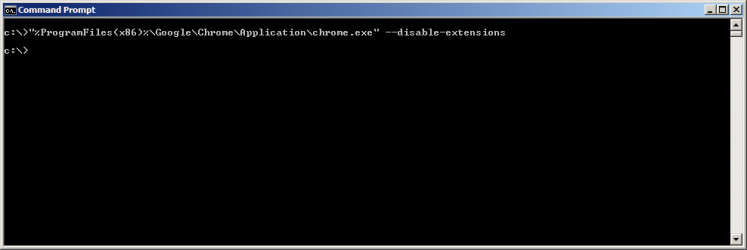

Please try this slightly different path to start chrome without any extensions:
"%ProgramFiles(x86)%\Google\Chrome\Application\chrome.exe" --disable-extensions
If that fails, please post a screenshot of the cmd window.
That line worked for me:
