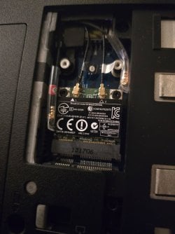

according to HP device driver info you have a Qualcomm card not Broadcomm
can you check the Details tab for the card and post the pci/ven details
if the driver is for Qualcomm, then check in the W7 Athorus wlan driver store
(the 2 companies merged)

I hope the picture is decent.
This is the Wlan card installed in the HP.
I tried pushing the activate wifi but nothing works.

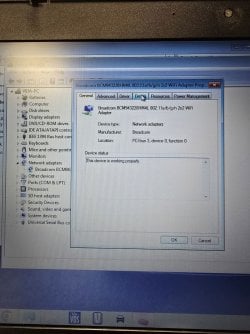

please open device manager, what does it say in the device status box
picture would be great

From what I can see, everything seems to be in order! I can`t figure it out why it won`t! It worked great with Windows 10!....

well thats weird!!!
other things to check, (assuming you used a vanilla ISO and not HP recovery discs)
was there an error code on that Broadcomm report
what does MS troubleshooter report
does the on/off key also require Fn key to be used, if its a keyboard F? key
download/run HP diagnostics
run sfc /scannow
if all else fails try a repair install -- no loss of files folders
major thoughts
that card is 2.4 and 5G check in the advanced tab making sure its picking up the same frequency that your routers is broadcasting on, and the security code is correct
