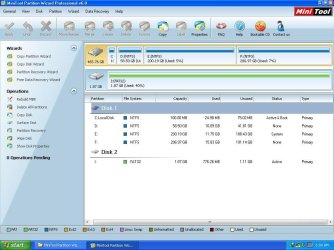

Boot PW CD, take a camera snap of the full Drive Map with listings showing all columns. If you cannot get a snap to post up, copy the listings down exactly as they appear for each partition.

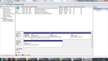

Here are the screen shots u guys asked for....

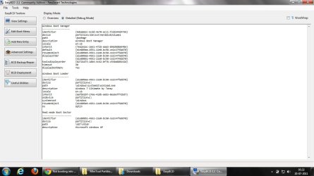

Well....heres what i tried earlier. I did a simple copy paste of the WINDOWS folder(Winxp) and in the drive D: and the easyBCD was then able to detect my xp setup and i was able to successfully boot into Xp. I am upldng the screenshot of easybcd these two boot entries...

But i wonder if i try to uninstall xp from there won't it delete the 7 as well...because acc to the easybcd both are located on the same drive even though i copied the WINDOWS(xp) to D:. Have a look at the screenshot i recently uped

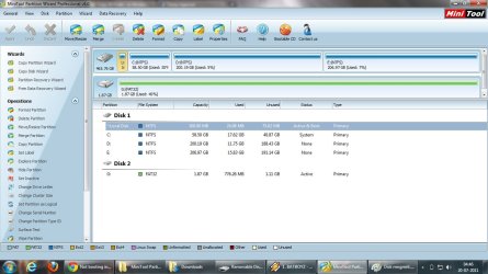

Can you post a screen shot of Disk management from Win XP?
Took me some time.........sry the disk mgmt was running in there

Your Drive letters in Windows 7 are C: D: E:
Your Drive letters in Windows XP are C: D: E: F:
This is why EasyBCD is showing Windows 7 as C: & Win XP as C:

They are working from the same partition.
