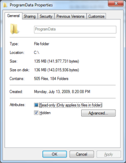

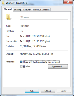

Did you do a Disk Cleanup after installation?
How big is C:\Windows and C:\ProgramData?
- HP normally creates a Drivers and App folder that can be big.
- Virtual memory (pagefile.sys) can be huge depending on the it's settings.
- Hiberfil.sys is the same memory size.

Thanks for response,
the disk was newly-formatted. and during install, almost running cleaning and defragment on every step. as mentioned, (HP 800 G1 OS size looks normal, 28 GB). but HP 8300 OS size is some 60 GB.
OS size in total (60 GB). about 20GB spare room on partition.
