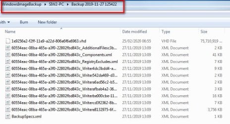

Where are you getting those dates from?
Did you check the date of the vhd file?

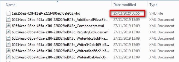

the vhd file is the actual image file.It is large.
It is inside the windowsimagebackup folder. Take a look and check the date on it

When you create an image older blocks are moved into shadow storage. The vhd file you can see contains the most recent image.
To restore from an earlier image than the date on vhd file requires accessing shadow storage, which you might not have if you are renaming/moving your image folders.
You could also do a search for *.vhd to find where they all are. I don't know what you are using for search, the free everything by voidtools is good

I double clicked on each of the windowsimagebackup folders and each Modified date simply stated the date I performed the backup image,
except,
the "WindowsImageBackup 11-14-17" folder which states Modified date 1-14-20. Wow. Yet, when
I click on properties, it says that I created the image on 11-14-17.
But it was just the other day, I thought, that I removed the date to read "WindowsImageBackup".
Was it my changing the name that altered the modification date? Maybe I read the date wrong when I restored using the image. Maybe it said 1-24-2020. My eyesight is not exactly the best.
Does that mean I actually already backed up using the 11-14-17 image file? If so, then that is exactly what I wanted.
