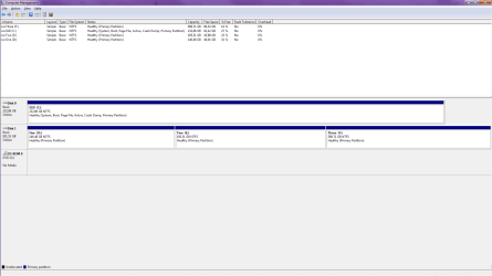

Please post back a screenshot of Disk Management - Post a Screen Capture Image
When you say "We solve problems here by replacing the Marvel with Intel for boot device", is that 'here' as in this thread. Meaning, you think switching from Marvell to Intel in this case will fix the problem. Or is it 'here' as in on this forum. Meaning you often solve problems by advising people to boot from Intel rather than Marvell?
I just now installed the Marvell driver. Honestly I don't know why I didn't before. I won't be able to tell if it makes any difference until I fail another boot, or, I don't know, several weeks pass without boot failure.

It looks correc.
Yes I did mean here in the forums. But try running with the correct driver for awhile to see how it performs. Keep us posted.

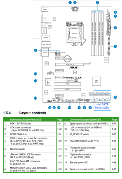

Yes I agree on using the Intel SATA ports on your board. Since you have a SSD you get much better performance than with Marvel even thought the Marvel controller is 6GBs. Here is a link to your board drivers page. Download them and save on a USB stick or place on a CD/DVD to install, or to your desktop if the problem machine is working.
Drivers: https://www.asus.com/Motherboards/P7P55DE_LX/#support The Intel SATA will be the Intel Rapid Storage Technology. This also has a BIOS 1701, check your to see if you have that installed.
Attach the SSD to the BLUE port labeled SATA1.
