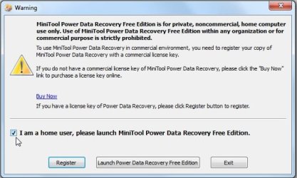

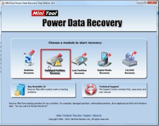

After that try coping out files/folders. If you cant see your files\folders the next thing is to try a data recovery program.
I would try this one:
Ther are different ones in hirens you can try.

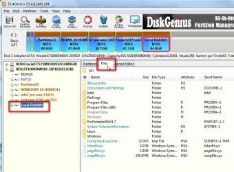

I think it is the same hiren that you have. I am posting my diskgenius screenhots from my current operating system, just to show you how it works.
It is probably taking a long time to load for you because of the sector damage.
