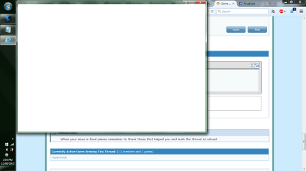

I think hang was the wrong word...
I've attached a screenshot of what IE does when I try to open it. It remains like this for 10-20 seconds and then dies before I can do anything. Resetting IE and disabling the DNS client didn't change this behavior.

W7 Pro SP1 64bit
i7
8GB
Intel HD Graphics
crappy SSD
Yes. No Add-ons does the same thing.

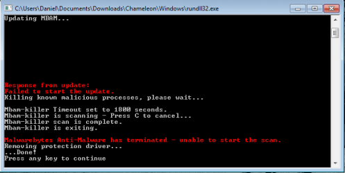

You can try scanning with Malwarebytes Chameleon in case an infection is causing these issues. Also try running in Safe Mode (with and without Networking).

Malwarebytes Chameleon has the same problem (on every mirror) as when I open normal Malwarebytes: I get a popup saying "The application was unable to start correctly (0xe06d7363). Click OK to close the application". (I've attached a screenshot).
After I click OK It says "failed to update" and still tries to scan. (See second screenshot).
