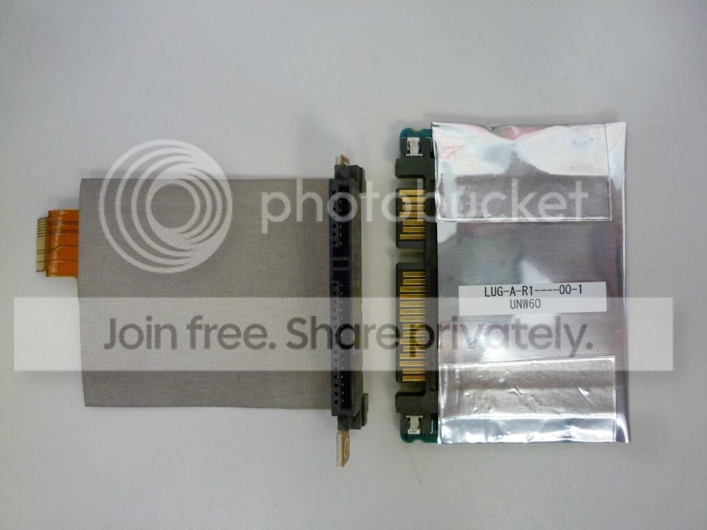

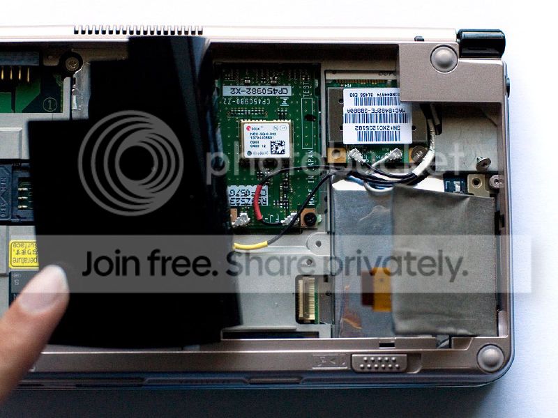

Meanwhile, SSD is more accessible that I had thought...after removing battery, I lifted up a thin plastic sheet in one corner and there it was underneath. Bit awkward to remove, but I got it out now...seemed like it was seated in there OK, but that's just from looking at it....
So, put SSD back in and reconnected cable, etc...
Just tried booting up and Voila!!! BIOS sees the SSD now and I can boot up normally!!!
Guess you just never know about these things....
Thank you all for your help!
For fun, I'm including the pics below of what it looked like under battery and the SSD and connector..

Thanks for your input.....posted pics of what mine looks like in post above...
