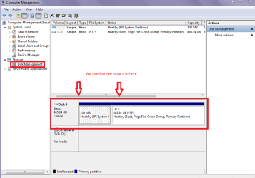

If you can do this too
Start > Computer > right click it > click Manage - it will give a small window and in that window there will be under Storage > Disk Management - click it and it will give you a pic of the disks and devices and if you can send back a pic of that screen. I have attached a pic of mine so you know what you are looking for.

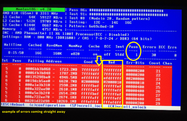

Ok well as a start I would be running this http://www.sevenforums.com/tutorials/105647-ram-test-memtest86.html as it seem as if it wants to boot but cannot load the RAM.
But I could be wrong but at least this will eliminate that cause - just remember to run for at least 8 passes any less and you may as well not bother and it is the only test we recommend here. If the errors come up straight away then you can stop the test. However if it still runs in a black screen when you boot from that memtest disk we shall have to look elsewhere.

Ok mate the memtest it is the only one we will recommend as per my earlier post.
Now the RAM is important because in a nutshell the operating system is loaded into it at boot up and if nothing is being loaded then the system will not run because it has no basic info up and going to run programs from or from within itself ie sfc.
The hard drive if you cannot get the system up and running then you have either have got to get it going by looking at other components (and as mad as it may sound even the PSU is a major source of problems withing the system but more of that after the memtest has been done) or you have to hook the drive up to another machine and run tests on it via the other machines system.

Now Majd I think I did specify that the memtest has to be run for at least 8 passes - two passes is just not enough because errors can occur during the subsequent passes after the first one or two. The test without getting too technical runs using different input and outputs and frequencies etc and while the two that you ran came back negative errors it may have just been that those two test passes/runs did not use the combinations that the software uses hence it may well have missed a pass that would have come up as an error. See the first few lines of this https://en.wikipedia.org/wiki/Memtest86
For an analogy take a car and rive it round a certain test circuit that has all the features that any road could throw at it and do that in first gear then second gear then third etc etc - doing that like that might not come up with any faults until you use a certain gear or pattern of gear changes driving that circuit.
I know it is tedious and time consuming but sometimes we have to eliminate problems using things like the memtest.
