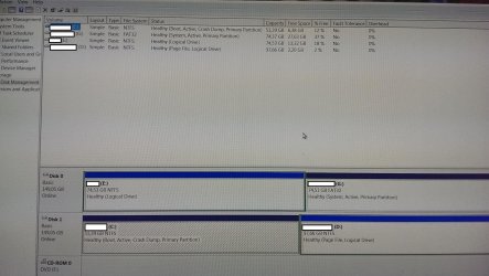

I'm trying to move my OS to a new SSD but up until now I have failed miserably.
I used both AOEMI and Acronis and I get the same result. My SSD will not boot showing the "Bootmgr is missing" black screen.
I've read a lot around these forums and the general opinion is that the Bootmgr is located somewhere else.
Unfortunately I cannot find a "System Reserved" in Disk Management to include it in my backup/clone.
I have two hard disks and it's probably the cause of the problem.
One is my C: with the OS (Disk 1)
The second is my very old C: which now I use just for data (Disk 0).
If I remove Disk 0 I cannot boot in Windows with just Disk 1.
If I keep Disk 0 and 1 I can only boot when in Bios the IDE (Disk 0) is on top.
My question is this. Is there any way I can create a working backup/clone to my SSD?
A search in My Computer for bootmgr gets me results in G if this is any help.
I tried removing Disk 0 and booting with the Win7 DVD but when I try to repair I get the "This version of System Recovery Options is not compatible with the version of Windows" message.
It's my DVD that used to install windows.

Your boot files are on the G partition on disc 0. That's why you can't boot if disc 0 is disconnected.
I suspect there is more than one way around this, but you could try copying the boot files from G to disc 1, C partition, using EasyBCD, following this tutorial:
http://www.sevenforums.com/tutorials/209885-bootmgr-move-c-easybcd.html
If that succeeds, you should be able to boot with disc 0 disconnected.
System Reserved isn't a requirement. It's normally where boot files are found, but as in your case, boot files can be elsewhere. I don't have a System Reserved either---my boot files are on C.
If you can copy the boot files and operate normally with disc 0 disconnected, you should then be able to clone or image disc 1 to the SSD.

I don't know if I made it clear in my previous post, but I can boot with the SSD as well (the backup/recover process succeeded) but again it needs G.
So I'll check it out and see if this works.
That's what I'd expect.
You apparently cloned disk 1. That specifically excludes partition G and your boot files.
Not sure how you ended up with such a convoluted setup, but you can certainly have C marked as system, boot, page file, active, crash dump, and primary.

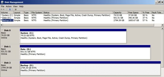

Here's a screen shot of my drives. C is an SSD. Note that I don't have System Reserved.

The reason that the System Boot files were placed on G is because the other hard drives were not unplugged during install of Win7, so it places the System Boot files on the first available Primary partition which in this case is G since boot files cannot go onto a Logical partition.
In addition to moving the boot files to C while marking it Active, then marking G Inactive, I would swap the position of the two disks so that the System partition is always on the first-in-order HD. This way in any future repairs or reinstall the boot files will not be derailed to a preceding Primary partition.
EasyBCD worked like a charm. I managed to boot with just the SSD.
@greg, yes that's the reason. Although it has been many years ago, I suppose I didn't unplug the other HDD. Thanks for the advice on unmarking the HDD.
