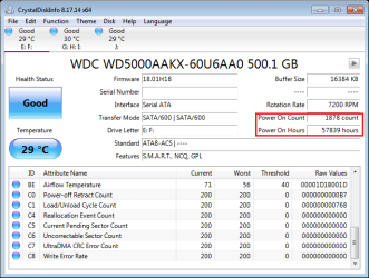

you can run CrystalDiskInfo to know the disk info.
typically, server disk has low "Power on Count" number, as low as 3 digits ( i.e. < 1000), while, high number on "Power on Hours". If this number is over 50,000 hrs, it's suggested NOT in use any more. or use it in a NOT important place.
thanks very much for the help. so no test? just run chkdsk is enough?

CrystalDiskInfo is a free-tool (developed by an MIT guy), you can google and download it.
