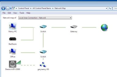

Here's the ipconfig
I've also posted a clip of the network map. It shows that I'm connected to the internet. I'm typing on the other computer on the LAN and it's working perfectly so the Internet is OK.

Which device is the Win7 computer on the diagram you posted a few days back as I can't figure that part out from your posts. What also is the garynancy 5g device? Some sort of Wifi extender? Looks to be from the diagram but if you could confirm that would be helpful.
Add to that the question of the cabling - the 100m (or 328 feet) relates to a single run from point A to point B so that is very unlikely to be an issue.
The network diagram that I posted was generated on my Win 10 Pro computer ("Office" on the diagram). It is working perfectly. The diagram is not really complete probably because a number of devices on the LAN were turned off at the time the diagram was created.
The PC labeled "Nancy-PC" is the Win 7 computer that is giving me grief. As I mentioned in my previous post, that computer connects to a 5 port switch using a 35' cat 5e cable. The switch is connected to the cable combination router/modem using a 65' 5e cable.
"garynancy-5G" is the 5G WiFi band and my Denon A/V receiver connects via the 5G band (i.e.for internet radio).
