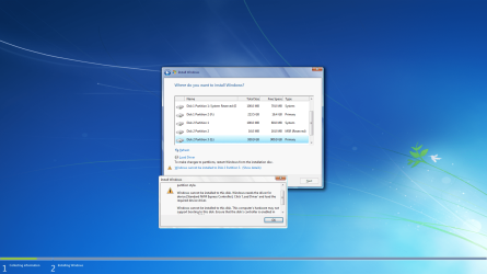

I wanted to install Win 7 to the NVMe with no success . The 2 SSD HDD that I have running on the system will only work with the RJ45
That was my first problem the ( Realtek PCIe HE Family controller was found to work.
The main issue is the failure to recognize the M.2 PCIe 1TB PNY 2230 from within the running win7 os
The PNY NVMe does show in the BIOS.
The final solution was to boot to USB Win10 UEFI and install This was not what I wanted. All my attempts to create Win 7 Media using 7upv64P and install would not recognize the NVMe
So now I do have an NVMe drive function But only through the win 10 installation
I can not see what relevance the board has to the media creation to supply the NVMe drivers for a win7 installation. I must have made a mistake creating the media. I am still looking for the resolution. If win 10 can see it and supply the drivers, it can not be anything to do with the MB
I wanted to discuss what I was doing wrong, creating media. I used Rufus 3.10 to make UEFI USB
It would not see the copy pasted revised media. It will only work with ISO image. I created standard rufus media and wrote over the files with copy past of revised media. ( did not work ) meaning the NVMe drivers did not show at isntall
As I said in the beginning I tried from the SSD HDD first, then creating the UEFI USB

There is no need to do that. The win7 image could be applied from install.wim direct to a partition by using dism or dism++ or wimlib or gimagex or winntsetup or even using win10 setup.exe
But the applied win7 image won't see the nvme disks unless it is updated with nvme driver.
pjlucky
you can borrow my boot media
17514x64v30.iso
check if it can see the nvme disks.

I will need to get some DvD discs to burn to Unless there is a way to burn to a file on the HDD
I do not have such software .
On another Note I want to point out, what I consider a mystery.
Why now after installing win 10 to the NVME does it show , When I boot to win 7 from the SSD HDD . But If I run the win7 install media it shows but says can not install to drv 2 there is no NVMe driver

I really messed up. Some how I deleted the primary SSD and lost everything from the past 2 yrs >( that was not on The older SSD ) I know I should have unplugged them .It would not have happened
This is a fresh install
I will reinstall the NVME and try again.
- - - Updated - - -
Thank you SIW2
I have now succeeded to install Win7 to the dang NVMe , Now to get the Xp environment into it.
I did lose the main drv and all it contained to the errors of Xmass day.
I do not know if there is a solution to the WiFi M.2 since there is no support for Win 7 that I know of.
What I used in the end was the USB created from the original 7UPv64P and Rufus 3.10 ( no idea why after all this the NVME shows up )
For some reason the USB external SDD HDD that I put your software on would not boot after the fiasco.
Mistakes made were to format drives. this caused the software to refuse to install .( incompatible format) The damaged drives even the SSD HDD had to have there partitions deleted, Only after this, reformat and then install new OS.
