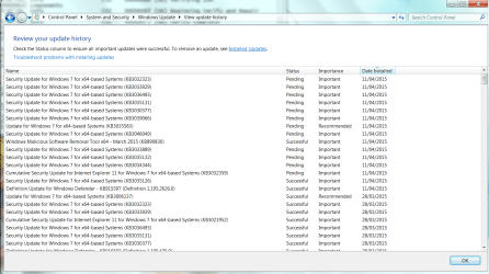

I've narrowed it down to one of the updates in the picture 'Insupdates.png'. Sorry, I know that's probably not as helpful as knowing the exact one, but it takes a little time for the problem to manifest.

When Windows Updates cause unbootable Win7, System Restore to before they were done and then install them in small groups or singly to isolate the problem update. If it won't install start a Support case on Windows Update website which offers free email support.
You may need to make a new System Repair Disk or obtain media for your licensed version as discussed in Step 1 of Clean Reinstall Windows 7.
You can do a Repair Install on Factory OEM, you just need retail installation media for your version and not the Recovery disks.
But if you haven't done one yet then I'd opt for the vastly superior Clean Reinstall Windows 7. Everything needed is in the blue link to get and keep and perfect install.
