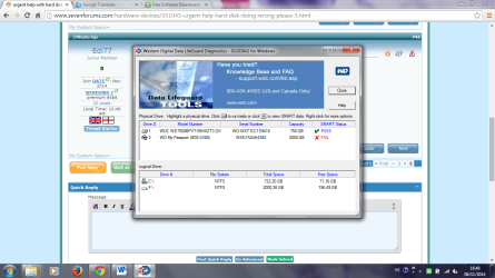

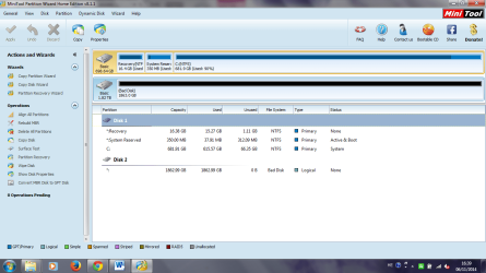

This problem you're having Edi is quite confusing and it's really difficult like this to determine what's the cause or how to fix it (if it can be fixed). This would require a more professional and technical, with all the tools needed, look.
All I can tell you for sure is that summarizing the symptoms: drive appears and disappears periodically, files seen, access denied, analyzing programs give out the drive as “bad”; I could conclude that more or less this hard drive is failing. Slowly, but surely. To why this is happening, one would need more precise observation to answer this question.
My advice would be to stop experimenting and trying to figure out what you can do or how to copy the files yourself. You may be damaging the drive unintentionally and accidentally more!
Your files, all the photos, videos and other information you have, is right there, on the drive, we've seen that; they can hopefully be extracted, but it would be better done by a specialist.
Take it to a professional to take further advice and your most secure way to get your information back is to take it to a Data Recovery company. Here I'm pasting a list of WD's Data Recovery partners, you could take a look at them:
