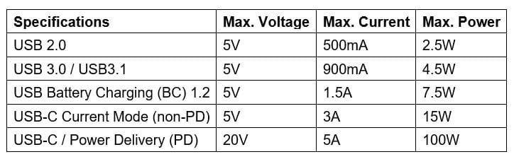

You are talking about two different things. The USB ports on a computer are all 5 volts. Their output current depends upon what standard they are. They can USB 2.0, USB 3.0, or USB-C.
USB chargers can vary both the voltage and current depending upon their capability and that of the battery they are charging. For example the charger for my Samsung S21 phone can rapid charge it at 2.6 amps at 9.3 volts for a total of 25 watts. I have seen other chargers with capabilities of 700ma, 1000ma, 1500ma, 2000ma, or 3000mA. Note that both the charger and battery being charged have to support rapid charging to take advantage of the extra charging current available. For example, one time after a power failure I used my laptop to charge my phone. The phone was probably charged at only 500mA because the laptop wasn't capable of rapid charging.

Okay, I think I'm beginning to get it. I can charge my Samsung tablet from my computer using a USB A-C cable.
If I use a USB 2.0 port it'll charge at 2.5W, a USB 3.0\3.1 port will do it at 4.5W.
I also have a couple of 'wall warts' (hate that name) that I guess might do the charging, too.
One is a Sony - 5V x 850mA, the other an Apple with a gutsier 5.2V x 2.4A (12.48W).
Is there an upper limit to the wattage that the Samsung tablet would accept? The manual says nothing about that.

Electronics will typically draw the current needed for charging or consumption while in use. So look on your tablet. What is the input charging current rating? if it's 2 Amps (2000 mA) then you should use a charger capable of that amperage on the output or more. Again, it'll say on the charger.
