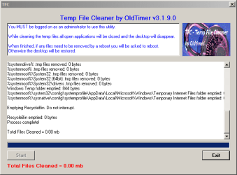

Following the instructions in this Tutorial, I tried cleaning out an infection (name unknown, but sorta a super Poweliks). It came up clean after running all 3 types of scans.
I know that's impossible. The hidden, evil :devil: X: virtual drive (installed within the C: partition space by the virus) was even listed as a choice for Custom Scan, along with Local Disk C: and System Reserved D:!
When I clicked "View Details", a box popped up saying, "You must be the Administrator Security to view these files."
I tried navigating to the location given in the tutorial, but no WDO folder was created at C:\Windows.

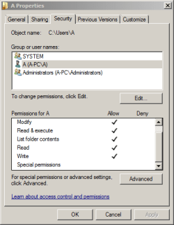

Thanks for replying, Layback Bear. Glad to have your help. The image you requested is attached.
My "C:/Users/A" account is a member of the Administrators group.
However, I may be blocked from actually affecting settings by the virus...

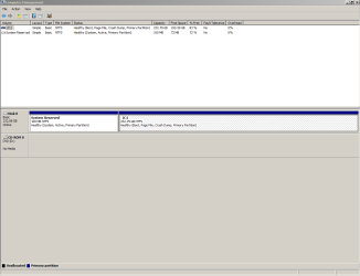

"System Reserved D:" is weird cuz it never has a drive letter that I've seen before. But the choices for a Custom Scan in WOD listed it exactly that way. Also listed were "Local Disk C:", my DVD drive as "E:", and the VM where the virus installed XP as "X:".
I've used Parted Magic, Partition Wizard, Bart's PE, Macrium Reflect, Seagate's Acronis Free. HP's hard drive manager, Paragon, D-Ban, Daricks Boot and Nuke. None ever gave System Reserved a drive letter, but once the VM was listed as "V:"; another time as "h:". Sorry I didn't write down which app showed what, but both wipers failed to touch the VM located within partition "C:".

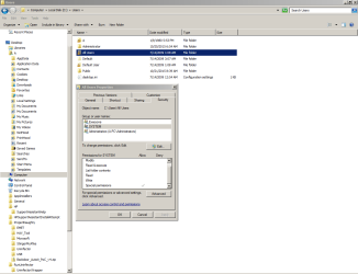

You will find that some 3rd party programs will change partition letters and drive numbers around.
What I do is change the name of each drive and partition so when a program changes the partition letters or drive numbers I can use the name to make sure I know which one is which.
The computer I'm on now has Systems also with all check marks, (Full Control).
I have also ran Windows Defender Offline and never got a log I could find. I always thought that if WDO didn't give any other instruction when it was completed; it didn't find any problems. I do not remember how I got that idea.
Are you able to run sfc /scannow?
If so what results do you get?
Reply inserted into your quote in purple text. Thanks again!
You will find that some 3rd party programs will change partition letters and drive numbers around. I've noticed that, but this is a Windows program.
What I do is change the name of each drive and partition so when a program changes the partition letters or drive numbers I can use the name to make sure I know which one is which. Good idea. I hadn't worried about it since the whole disk is one partition used just to find out how to get rid of this infection. Done now, though, Layback!
The computer I'm on now has Systems also with all check marks, (Full Control). That's not what I'm seeing. If you look at attachment 375091, only "Special permissions" is checked
I have also ran Windows Defender Offline and never got a log I could find. I always thought that if WDO didn't give any other instruction when it was completed; it didn't find any problems. I must be getting really paranoid after months of fighting this thing! I always assume the infection has done something nefarious when a 7 Forums tutorial says I'll have a log and I don't. :mad: I do not remember how I got that idea.
Are you able to run sfc /scannow? I did - it said no problems.
But remember, it is scanning the Windows 7 drive "C:" that the VM XP OS installs whether I insert a Windows 2000 Pro, XP Home, Windows 7 Universal install disc, or the Windows 7 disc shipped with the PC!
If so what results do you get? Text file attached.

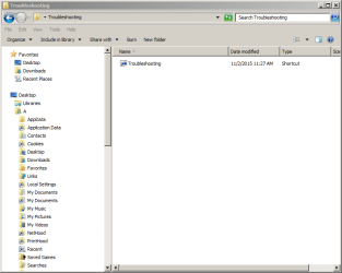

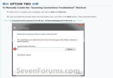

Sometimes the oddest things can trigger an idea for an experienced person like you, Layback. I found the following really odd...
One thing this infection does is allow hundreds of "Authenticated Users" to log onto my PC remotely, so I decided to look into that. To save lots of future clicks, I decided to make Brink's shortcut.
I used Option One, the downloaded zip file. When I double-click the Troubleshooting desktop icon, it sends me to this target:
When I double-click "Troubleshooting" there, I get:
That didn't seem right, so I signed back in to 7 Forums and went back to Brink's instructions for manual creation of the shortcut.
Notice that Brink specifies "%systemroot%\system32\msdt.exe -id NetworkDiagnosticsInbound" as the shortcut's target.
This is the page the virus redirected me to as if it were 7 Forums, with the target location changed!

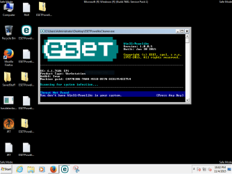

Doggone it, ESET didn't work either. Tried it 3 times, and this is the screen that comes up immediately after double-clicking the exe icon.
Here are the 3 log files. Does this tool really do its work in a millisecond?
Any other suggestions?

Okay good, now download TFC by Old Timer TFC - Temp File Cleaner by OldTimer Download - Geeks to Go Forum and save it to your desktop.
Save any unsaved work. TFC will close ALL open programs including your browser! This will also hide all desktop shortcuts, so just be aware! They will come back after rebooting. ;)
Using Vista/Windows 7 right-click on the file and choose Run As Administrator.
Click the Start button to begin the cleaning process and let it run uninterrupted to completion.
Important! Manually reboot the machine to ensure a complete clean.
Tell me how your computer is acting now.

TFC never hid the desktop icons. Here's what it showed it cleaned.
View attachment TempFileCleanerLog.txt
I ran it a second time after restarting because I wanted you to see there wasn't a "Restart" button presented after the scan in the log, and this is what it looked like.
I'll have to spend some time using the PC in the morning to report its behavior. UG
