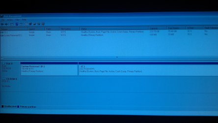

can you get us a diskmanagement map?

I realize this isn't the ideal way to get the screenshot up here, but snipping wouldn't work and if it did I'd have no way to go about getting it off the computer anyways, as it's not letting me access anything, even trying to explore the drive.
Why do you have a System Reserved partition that has a drive letter and is not active? Was this intentional?
Before following the advice for the 30 day trial partition software, I would recommend reading through http://www.sevenforums.com/tutorials/219533-troubleshooting-windows-7-failure-boot.html
I have asked the author of that tutorial to take a look at this thread, as well.
I'm using a laptop hard drive as the main drive for this computer. That is how it was formatted when it was in the laptop, I've made no changes to it since. I've since got the boot loader set up to read Windows from the correct folder, now I'm experiencing an issue where it will load up, then shut the screen off before it logs on...
