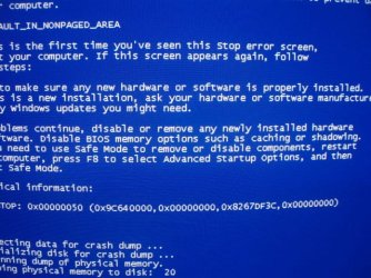

I had made another attempt to install and it was nearing the end. Completing Installation and then this happened.
I shut down.

Can you browse in using this method to see if there is a C:/Windows/minidump file you can copy out, zip up and post back for analysis? Copy & Paste - in Windows Recovery Console
Right off the bat it looks like a memory problem.
It appears that I can browse but I don't exactly know what I am looking at or looking for.
I was not able to find C:/Windows/minidump or any other file that might be a dump.
