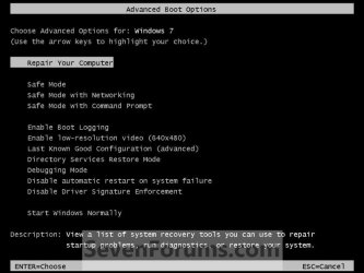

How are you getting to this boot option menu? I'm not familiar with it.
For the Advanced Boot Option menu:
With the computer off, press the power button. As soon as you turn the power on immediately start clicking the F8 key (top of keyboard) and keep clicking it until you see the Advanced Boot Options menu. Use your up/down arrows to highlight Safe Mode and click Enter.
Are you not able to access this menu?

Also what about the error message that showed up after the diagnostic process?Anything to worry about?
That's still not the Advanced Boot Options menu you should be seeing (post # 4 screenshot.) Try once more please. As soon as you power on the computer immediately start clicking the F8 key (about one click every second) and keep clicking until the Advanced Boot Options menu appears. If you still can't access the Advanced Boot Options menu then there is something seriously wrong with the computer. It may require the use of a rescue disk so you can backup your important data and then reformat the hard drive.
I know you don't want to do that so it's really important to know for sure that the Advanced Boot Options menu cannot be accessed.

Thanx for replying.No i still cant access advanced boot option :(
I think I would try a repair install. The link is in post # 2. It appears that there is more damage to the hard drive than the usual repair options would be able to fix. The repair install should save your data while fixing the operating system.
If the repair install doesn't work, then you might have to follow the instructions in post # 7 of this thread. This person couldn't start his computer and needed to backup his important files. He used a Linux progam called Peppermint3.
