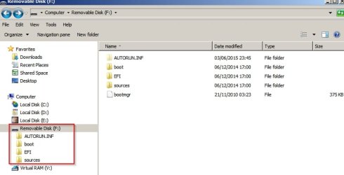

If you want to check contents of the USB before using it - it should look like this:

The data on the stick looks more or less the same as your attachement. Boot, efi, sources, support and upgrade are all in folders. There are a couple of other files beneath these folders among which autorun.inf (which on your image is a folder).

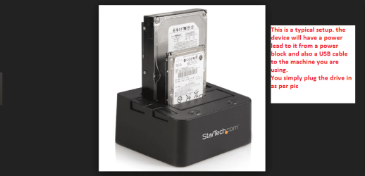

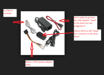

Now do you mean what I posted about the SATA to USB adaptor? because that is jut a way you can hook up say your OS drive to another machine and then do what you want to do and that could be anything from running a test on it to cleaning it to retrieving data. see pic it is of a very basic one but you may get the idea of how this works. I also like a dock and that is a block design that you plug the drive into and then just run the USB connector to the machine you are using.
Now of course go with what you are comfortable with and don't think you are boring us it is all part of the forum:)
