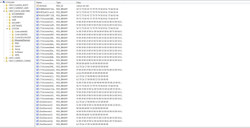

Start REGEDIT and goto key HKEY_LOCAL_MACHINE\SYSTEM\MountedDevices
Post screenshot with all values visible
Post screenshot of disk management with all fields visible as well

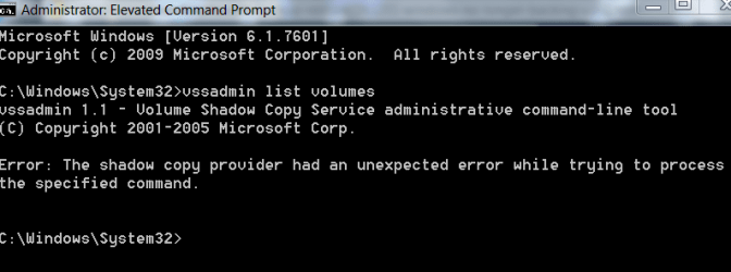

In elevated command prompt
vssadmin list volumes
post output
like this?
disk management screenshot please!
Microsoft Windows 7 Home Premium 64-bits 7601...Intel(R) Core(TM) i3 CPU M 370 @ 2.40GHz4,00 GBATI Mobility Radeon HD 5400 Series
ACER ASPIRE 5742G
Acer Aspire 5742G
4,00 GB
WDC WD5000BEVT-22ZAT0
like this?
The initial VSS error: Volume Shadow Copy Service warning: VSS was denied access to the root of volume \\?\Volume{4a2209a7-3a1e-11e1-87c0-88532e3b8b47
In REGEDIT this number is also found! Look at the data next to it. That number is exactly the same as at \DosDevices\Q!!
