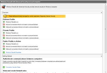

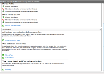

The firewall is technically managed by Kaspersky. I have looked at some of the other posts but perhaps it is time to raise a ticket with them. After all KIS is paid software...
