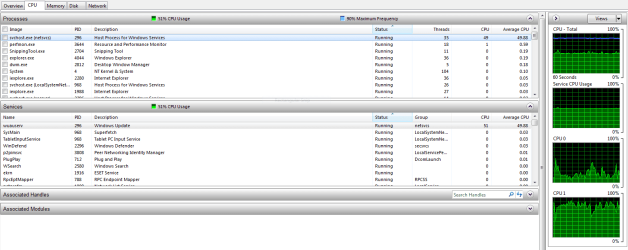

Hi, i'm having a hard time with Windows Update. When i check for for updates it gets stuck and even if i dont check for updates, the Windows Update service starts anyway. In both cases it is accompanied by high CPU usage as shown here:
List of things i did:
1. Anti-virus scan (nothing)
2. Windows Update Troubleshooter (didnt fix it)
3.Check Disk for Errors (no problems were detected)
I eventually tried Resetting Windows Update Componets Manually (following step 4)using the proccess described here:
https://support.microsoft.com/en-us/kb/971058
I ran into trouble Reregistering files (step 6).
Many .dlls were NOT successful, such as regsvr32.exe shdocvw.dll (pop-up message said something along the lines of "Connected but failed to register, check if .dll is vaild and try again later'')and some more which i cant remember. That said, i completed all steps because i didnt know what else to do.
The results were the same as before apart from having my Update history whiped and new folders in Windows (don't know if i need the two them in each file):
No solution to this has been found yet. Please help.
