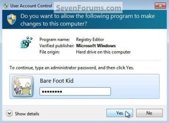

1) In the Windows start menu search box type regedit, right click the entry, click Run as Administrator, enter your user credentials for the UAC prompt, then click yes to open regedit.

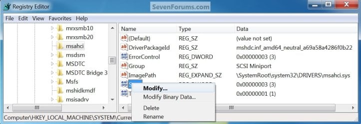

2) In regedit navigate to HKEY_LOCAL_MACHINE\SYSTEM\CurrentControlSet\services.

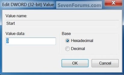

3) In the left pane, click on msahci, in the right pane double click on Start to modify it.
4) In the window that opens change the value to 0 (zero), and click OK.
5) In the left pane, click on iaStorV (if there), in the right pane double click on Start to modify it. Repeat step 4, and go to step 6 below.

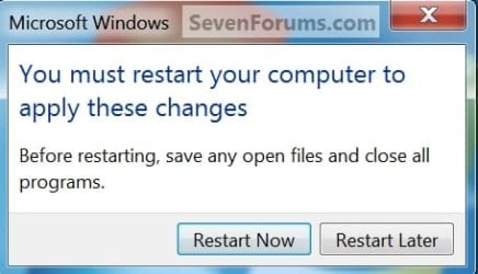

6) Close Registry Editor.

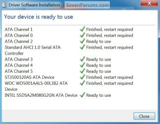

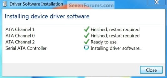

7) Now you'll need to restart the PC and go into the BIOS and enable AHCI. When Windows boots up, it will finish installing the AHCI drivers.
8) You will need one final restart to finish the process after the drivers are installed.

Step 3 is not too clear since your talking about pressing r in right pane and dont mention which entry that is since its covered by the menu. I assume you mean "Start" but in my case its already set at 0 since I enabled AHCI in bios so I assume I dont need this?
Hello Nick.
It says above to "In regedit navigate to HKEY_LOCAL_MACHINE\SYSTEM\CurrentControlSet\services, click msahci, in the right pane r. click "start" then click "modify" ...
