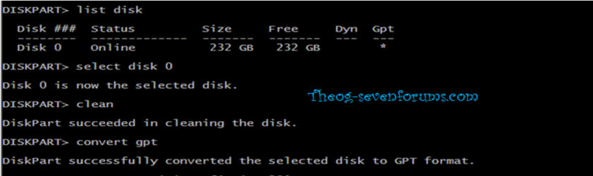

From diskpart
list disk
select disk ?
clean
convert gpt or convert GPT

For uEFI partitioning.
Diskpart

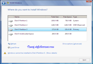

As seen in Disk management
Windows 7 installer.

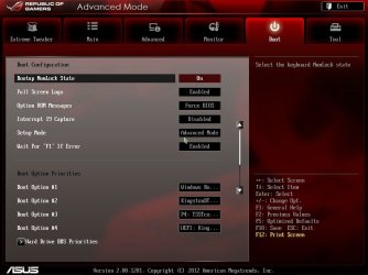

OK, did what I said I was going to do, which I think is what was suggested.
Disconnected all drives except the opticals.
Flashed the BIOS with USB (BIOS #1703)
The I selected "optimized defaults" - before and after screenshots show no difference in boot order
The screenshots document everything, including the remaining boot order chaos.

Your first boot drive is in uEFI mode.
