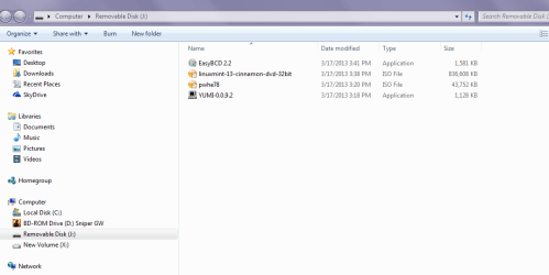

Part A - Create the bootable Partition Wizard and Linux USB
YUMI can support several bootable ISO's concurrently, so its advantageous to install both Partition Wizard and LinuxMint13 to the USB flash drive, one after the other.
Step 1
Download YUMI, Partition Wizard and LinuxMint13 from the links provided earlier.
Step 2
Insert your USB flash drive into the computer, and then run YUMI.
Step 3
On the YUMI interface, do the following:
- select the drive letter corresponding to the USB flash drive
- place a tick in the Format Drive box (the USB flash will be formatted to FAT32)
- scroll down the distribution list and select Partition Wizard (Partition Tools)
- browse to locate and select the Partition Wizard ISO you downloaded earlier
Step 4
Click the Create button to install Partition Wizard to the USB flash drive.
   Warning
Take note of the format warning message that is displayed - the entire USB flash drive will be formatted to the required FAT32 format, so double check to see that the correct USB device is selected.
Once complete, you will be asked whether you wish to install another ISO/Distro. Click Yes, and then select the LinuxMint13 ISO as shown below. Clickm2.png
Click the Create button to write the install LinuxMint13 to the USB flash drive. Once complete, exit YUMI. For ease of reference, we will simply refer to this flash drive as the YUMI flash drive from here on in.

Hiyya Golden Mate have a little problem in that I set the machine to boot from the USB and it goes to a black screen witha flashing white cursor and after about two minutes it lets out this continuous high pitched sound like the initial RAM beep. I then have to shut it down and now don't know what could be the problem. I have tried formatting the stick to FAT32 and NFTS with the same result??
Any ideas please? - should I have the separate items on different drives

John - as far as I know, you cannot install Linux under UEFI, or at least not very easily??? You would have to revert to classic BIOS (for both Linux and Windows 7) to install as a dual boot.
This tutorial was specifically written for BIOS - I have never tried this using UEFI.
@John ICIT2LOL - the UPS should have no effect on trying to boot from a USB. have you tried unplugging it to see what happens?

Yes mate I have tried it twice now and both times it sets that UPS off. I'll try it again tomorrow from a non UPS point.
The computer is an old one (originally XP) with a single core Pentium 4 630 and 4GB DDR RAM so I am thinking maybe that has something to do with it. Though it does boot 7 and XP (separate drives not plugged in together) ) almost as fast as my Sandy Bridge and quite the fastest oldy I have ever had.
The board is an Intel 915GAV (J2E1) (chipset i914P/i915G) all temps are really good.
So as per my post I might just have to put Mint on it's own dedicated drive .

Having Mint on its own drive will also work nicely......but how will you install it? You will still need to use the USB method right?
