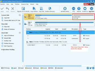

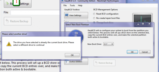

Hello Colin now mate I have got to the EasyBCD part and am stuck with what is in the pic I am asking you because I don't know if Wolfgang is still around as you know we haven't heard from him for some time.
So far I have made the Yumi stick and I have got Ubuntu on it as I prefer it to Mint. The partitioning bit I have already done as I have Partition Wizard already on my machine.
Now I am also asking if I am on the right track because I tried this on my tester machine No1 - it booted to Ubuntu and then after asking me to reboot the whole machine has become unusable I cannot even get into the BIOS and I don't want my 7 test machine No 2 ending up in the same situation.

Any ideas on this or is it not possible to boot the version of Mint I have on the stick I should say it is 64bit version or is there something I am possibly missing.

Just to let you know Colin my experiment worked I just slipped Mint into the partition I made for it and booted form a disk.
It isn't the prettiest of boot ups but at least I can run both now.
