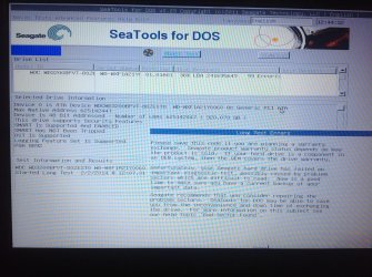

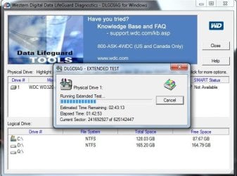

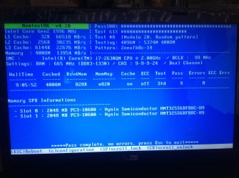

I did a lot of tests for both RAM and HDD. RAM is good, but I found Bad Sectors in HDD. My HDD passed short test, but not Long Test.

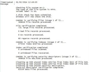

Checkdisk result
Checkdisk result
