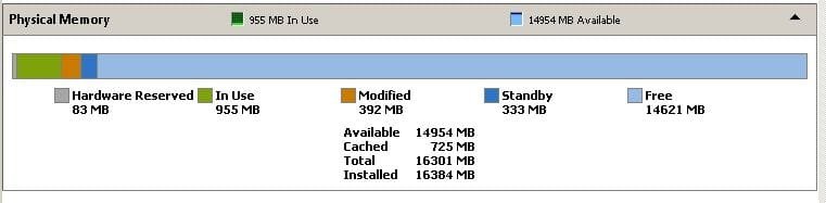

can you boot to the desktop, do start > run > resmon > memory and post a screenshot? Here's mine to show what I mean..

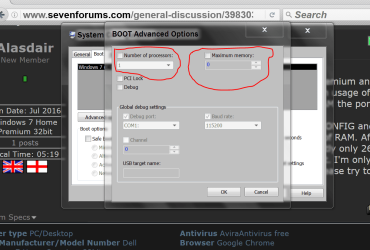

That much hardware reserve can be caused by mismatch ram, ram installed incorrectly, bad ram slots or bad ram.
Check this on your system. It should be as mine.

Check your Boot Advanced Option as per my picture.
Post a picture as I did of your Boot Advance Options.
Jack

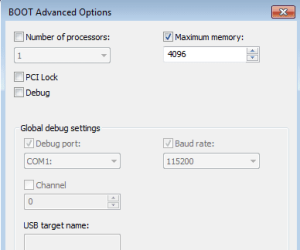

When was unchecked was O
When was checked was 4096

Leave them unchecked. That should help.
Reboot and post another picture like your post #7.
