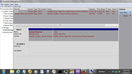

  • Make sure the C drive is a Primary partition before you begin. Type diskmgmt.msc into the start menu to access the above window.
  • You must have a Windows 7 Installation or Repair disc to do this. If you do not have a DVD, you can create a Repair Disc.
EXAMPLE: 100 MB System Reserved Partition

Ok. Mark C: as active, remove disk 0, and try the startup repair again to see if it's able to repair the boot manager after a few runs.
In addition, double check your BIOS settings to make sure that C: is listed first in the boot priority, or second after the CD/DVD drive.
That did it. Rock and rolla. Thanks!
